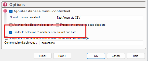

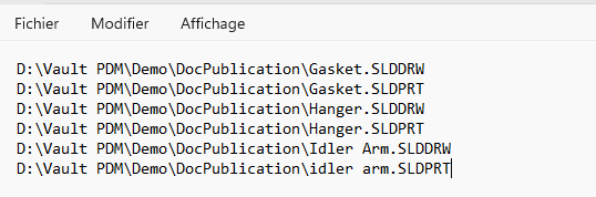

  • Treat a CSV file selection as a list: Allows you to run tasks on a list defined in a CSV file.
You need to create a text file with the .CSV extension that contains only the list of files

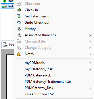

Enable the option in the task:
Then right-click the file / start the task:
