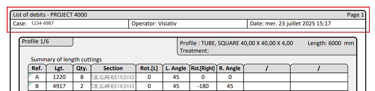

Manual values:
In this context, you can enter information about the current project.
This information is included in the report.
- Quantity:
This option allows you to manage quantities at the project level.
Example:
The project includes 10 cuts for the “Carré006” profile and 20 cuts for the “Carré012” profile.
#NOM?
The report does indeed include the number of cuts specified in the project.
#NOM?
In the report, the quantity of cuts specified in the project is multiplied by 2.

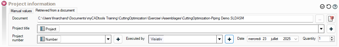

Values retrieved from a document:
From this tab, you can define the information for the automatic report by retrieving SOLIDWORKS properties from a document using the field concatenation tool.
If you close the tool, the information is saved, so you don't have to reset it for each new project. However, you can reset the tool by clicking on this button
