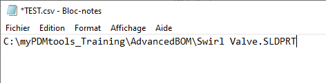

      In the case of a CSV file, it will be parsed and the files or folders listed in it will be processed. The CSV file must be in the following format (including the full path to the file):
